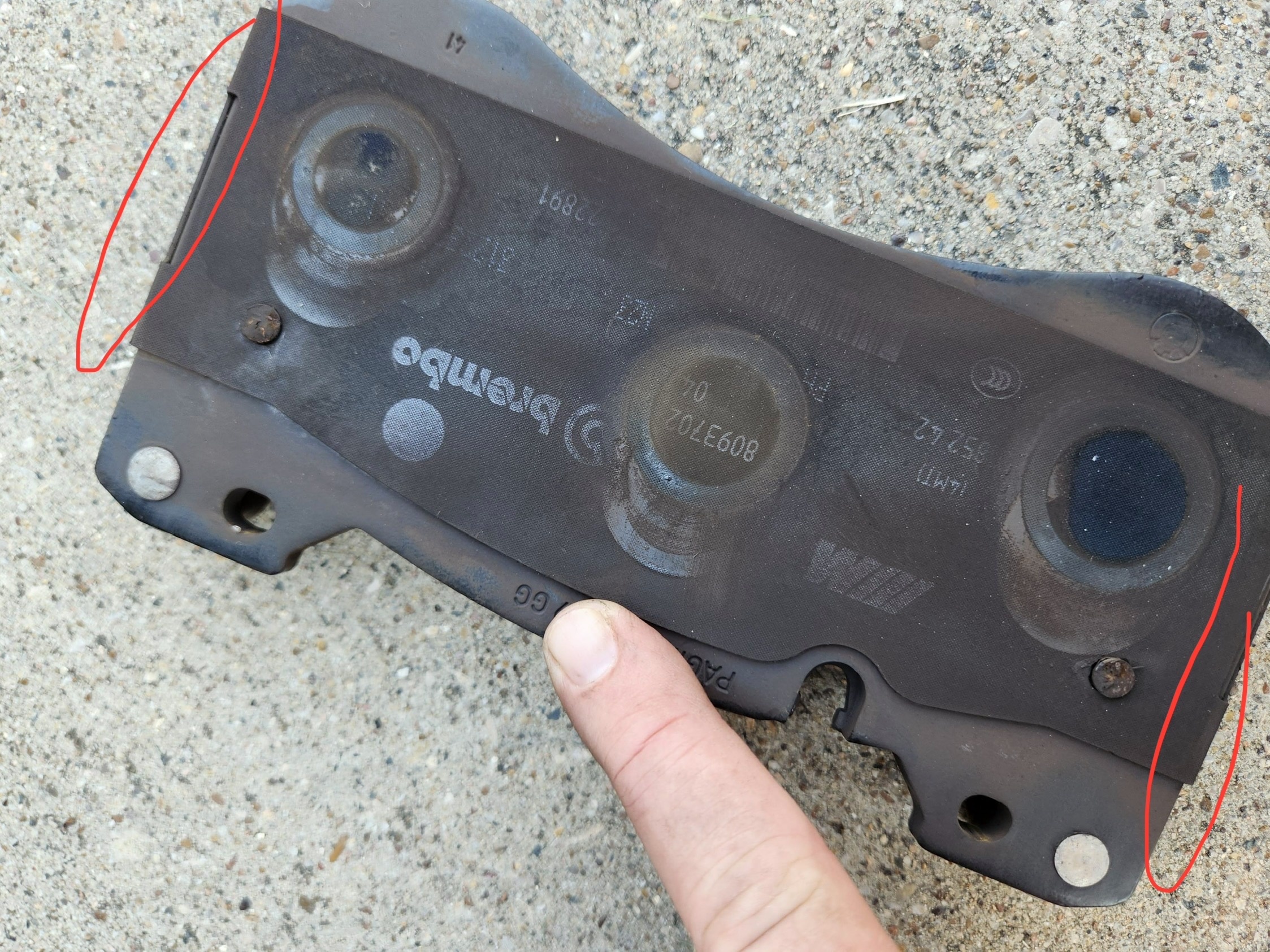

I have received your email from you to iSweep Japan.
Based on my observation, either your pad is not greased on the outer edges that in contact with the caliper or your installer used force to insert the pin.
I noticed a dent on the guide pin hole. I will check my stocks at the office tomorrow morning to confirm how it is in new condition.
Youre a freakn legend for reaching out to me - I truly appreciate it.
My understanding (please correct me if Im wrong) with the pins is that after the caliper assembly is placed back into the rotor, the pads shift around in that process since it's a tight fit and the installers need to manipulate the pads a bit for the pin to fit from one end to the other.
As for greasing, are you able to show me exactly where they should have greased a bit better?
Additionally, are the pads side specific (Drivers vs passenger) - no mechanic has confirmed this

Here attached on where to grease.
Yes, you do need to manipulate the pads to get the pin to slide through easily.
But in no mean to force the guide pin by force to slide through the holes.
You slide the pins with caliper off the car or on the car.
Per BMW process, pads need to be installed with pins on the caliper while the caliper’s off the car.
Also, the front pads no side specific.
Only the rear has inner and outer designation.

On the front, you are not supposed to put grease on the back plate where the pistons touch. Only on the edge touching the caliper.
