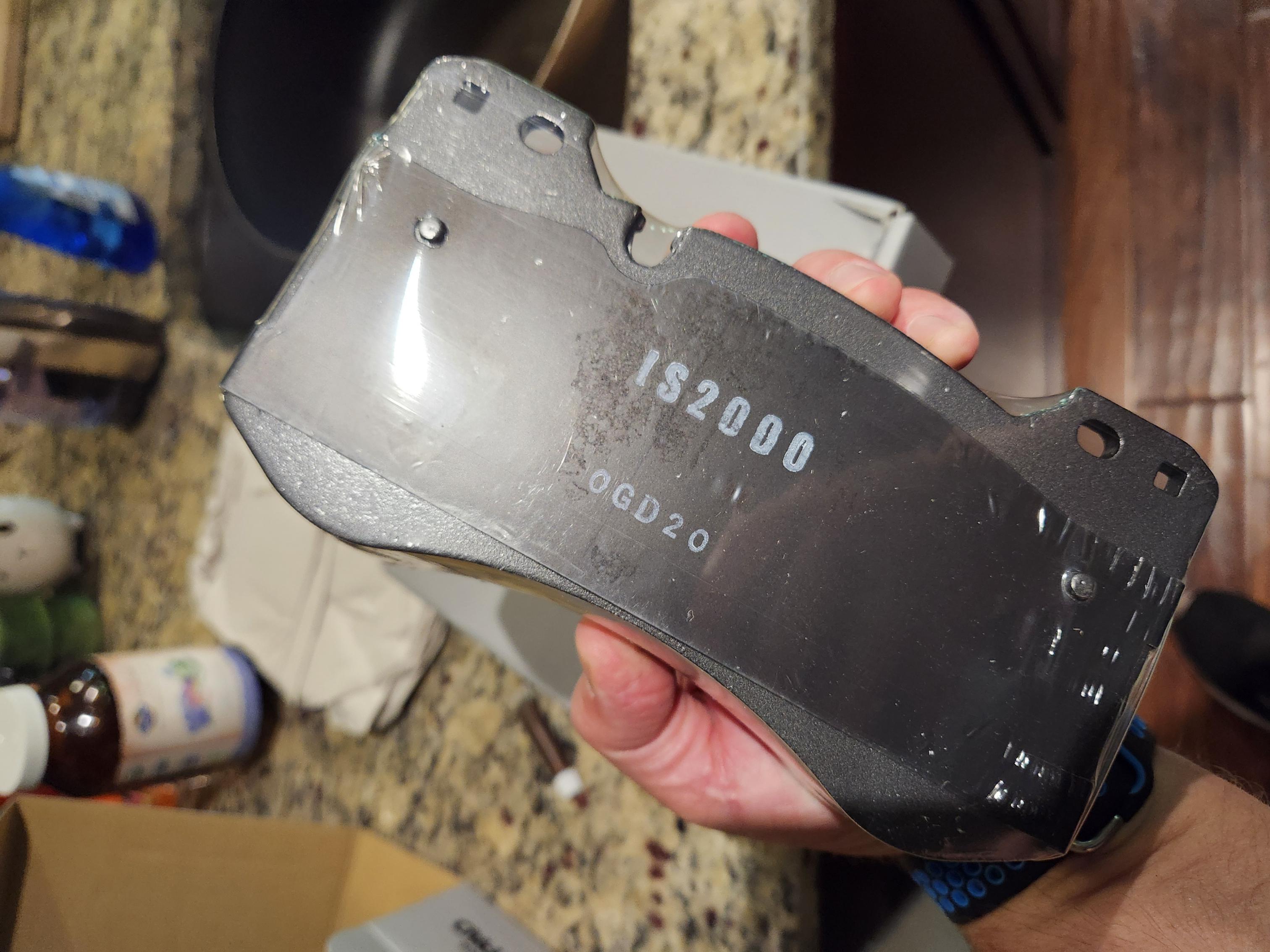

As a quick follow up, I also took a video and have a possible hypothesis. I tried to wiggle the pads as best as I could, with my fingers, while they are installed. The outer pad had no movement but the inner pad I could slightly wiggle and it makes a noise. See this video below:
https://www.dropbox.com/sc/e7kiux44q...ySXs7cZ01KTxpa
I also took off the driver's side wheel (which doesn't seem to have a rattle coming from that side while driving) and the outer pad didn't move at all but the inner pad would very slightly wiggle but oddly didn't seem to make any sound.
As a result, I suspect this comes down to the iSWEEP pads not having any kind of shim on the backside of the pad. It's simply the metal backplate, which would be up against the pistons of the caliper. The OEM pads do, as shown in the picture. If this is the source of something as annoying as a rattle while driving then really I would have expected better from an $750 (all 4 wheels) set of pads.

The iSweep front pads does come with shim. Could you take it off and take a picture?
Also, your movement is only on the inner side, this is caliper issue that I encountered before.
Try to swap the pads and see of the movement moves. If it doesn’t, then it is the caliper.

Hi, r33_RGSport , I'll see if I can get around to tearing it all back down sometime soon. It's been 103 degrees or higher each day and makes working on the car outside (which is my option where I live), rather miserable so will have find time on a weekend morning, more than likely.
Should the pad shims have already been attached to the pad? Unless they were separate and somehow left out of the box then I don't know how I could have missed them. I noticed the shims being present on the factory pad right away and took note that the iSWEEPs didn't have one. I ordered them from ECS Tuning. I recall noticing that the back of the pads were just the metal backplate of the pad with no additional shim of any kind .
Last weekend when I made my previous post, I did notice that like others have noted, the inner pad had an ever so slight amount of wiggle/play but the outer did not. It was only my passenger side that would make the clicking noise, which I noted in my video in my previous post.
I don't doubt that BMW will try to maximize profits by cutting out details. Unfortunately the majority of manufacturers do. It's about satisfying their stakeholders and padding their bottom line. The point here; however, is that the stock pads do not rattle. The new ones do. By logical analysis that would lead me to believe there is some sort of engineering detail related to the dimensions of the new pads that is not quite in stride with the OEM pads.

Whenever you have a chance, take them out and take a picture of the backplate. Shims should be there.
Yes, I have mentioned to Japan regarding this when I received this report.
My answer is from conclusion on what may cause it.
Because it is not possible to make inner and outer brake pads with 2 different jig.
And all the few reports that I have received, the rattle / movement only from the inner. What is the chance of all installed the possibly "Defective" pad on the inner, just doesn't makes sense if it is the pads issue.
While you have it out, try to swap the inner to outer pad, see if the play stays on the inner or moved to the outer.
If it moved to the outer, then it is the pad. If it stays on the inner, then it is the caliper. Same troubleshooting method that I have used.
Yes, I do have direct connection with iSweep since I am the exclusive importer and distributor for BMW Application.

As I mentioned. Try to swap the inner pad (the loose one) to the outer.
If the noise moved, then it is the pad. If it doesn’t, then it is the caliper.
Or something wasn’t put back correctly. Since all of my local installation doesn’t have such issue.

Originally Posted by ekook95 View Post
Have you found a solution to this? Im having the same issue with isweep1500s at the front
I have received your email from you to iSweep Japan.
Based on my observation, either your pad is not greased on the outer edges that in contact with the caliper or your installer used force to insert the pin.
I noticed a dent on the guide pin hole. I will check my stocks at the office tomorrow morning to confirm how it is in new condition.
