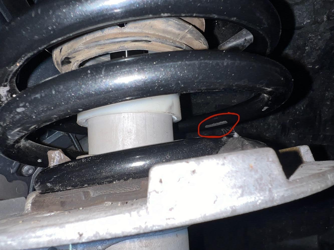

Eibach front springs grinding noise
Had the front only springs installed by a reputable shop in the Bay Area and both sides are making a grinding sound when going over uneven roads. Turns out the springs are making contact with metal surface (see photos). The kit did not come with bump stops so OEM was used - not sure if that’s what’s causing it. Any ideas?

Originally Posted by Luc@Speed&Tech View Post
Perhaps they are the incorrect springs? All the ones we’ve done are labeled 11-20-049–01 FA but yours are 11-20-049-03 FA
Thanks Luc I have a G80 base so bought the RWD springs with that part number. Your part seems to be for AWD according to their website.

F11-20-049-03-FA is M3 RWD front spring kit, are you RWD?
Edit: you already answered while I was typing. Make sure that your spring is properly seated in that black rubber, spring coil should go all the way to raised rubber notch (sorry idk how to explain properly, hope it is clear)
Thanks it’s a 6mt rwd and the shop has installed these before so I’m not sure if it’s an installation issue. Could OEM bump stop cause this since I did read the manual that if replacing front springs the bump stop will have to be replaced (not the rear).

6792
5,255
Where did you buy the springs from? Was it reputable? This kit comes with new bumpstops. Regardless of that, the springs don’t look right in terms of vertical coil proximity. Maybe you got some bullshit knockoffs or something. No bumpstops and noise is not a good sign for either your installer or the place you bought the springs from. The fact the installer didn’t stop immediately when they opened the box and read the instructions, which also indicate what should be in the box, speaks volumes for their lack of basic experience. You always check you have all the correct parts before starting an install.
Thanks I bought the springs directly from Eibach. They’re pulling some stock now to see if any are out of spec, but I agree with you that the springs don’t appear to sit right.
Springs actually look fine if you can trust this picture: https://eibach.com/product/E10-20-049-11-20
It is AWD springs that have consistent coil spacing, it appears that RWD springs have two coils very close to each other.

      08-22-2024, 07:22 PM   #12
6792
5,255
How positive are you OP that the springs are clocked correctly on the shock?

      08-22-2024, 07:47 PM   #13
Greggoryy
125
96
Drives: Tesla Model X Plaid
Location: California
Thanks guys for the input! I’m not positive that the springs were seated correctly since I didn’t do the job myself - going to have another shop take a look tomorrow to see if it’s an installation issue. Eibach got back to me and said they’ll send me some split tubing to put over the 2nd coil which will help with the noise, but I’m not sure that’s a long term solution…

Update: had a 2nd shop look it over and it’s not an installation issue, the RWD springs Eibach released in March this year causes this problem because it’s actually lower than the AWD springs that’s been on the market by about half an inch so there’s not enough clearance. A warning to those looking to buy the RWD springs.
Eibach said the AWD springs are on back order but they’ll be sending me some split tubing to cover the 2nd coil where it makes contact and if that doesn’t work they’ll send the AWD springs once it becomes available (October). Really bummed about having to re-do the install+alignment.
Wait, so instead of fixing their springs and sending you new ones (and I would add they should also cover your installation costs because it is their issue) they are sending you rubber tubing and springs for AWD?

Location: State of denial
Those pics sure make it look like the spring is "clocked" incorrectly into the base/support area. Probably just how the pic looks - I guess???
