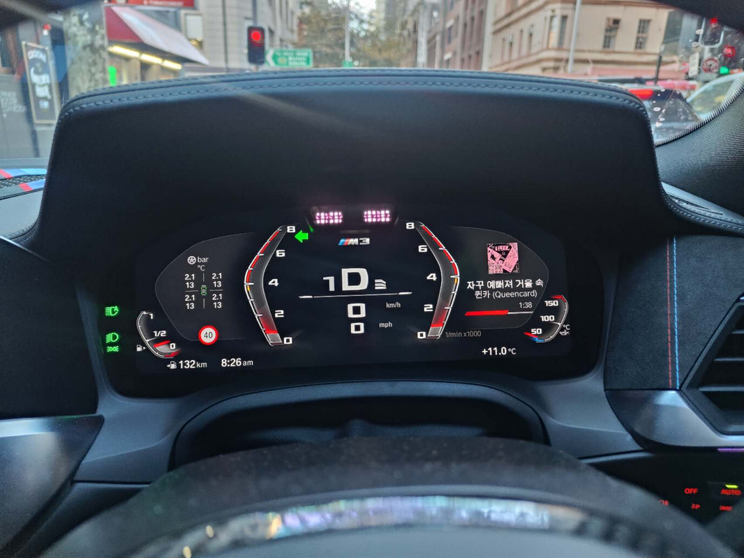

This morning, while driving my M3, I noticed that my engine's RPM was limited to 4000. Initially, I thought this might be due to the cold temperature. However, even after driving for a while and the oil temperature returning to normal, the RPM remained limited to 4000.
I have tried stopping and restarting the engine several times, but the issue persists. There are no error messages on the screen, and the fuel tank is full.
I have already scheduled a service appointment with the dealer for next week, but I would appreciate any suggestions or ideas in the meantime.
Please note that regardless of the temperature shown in my dashboard screenshot (which was taken at the very beginning), the oil temperature normalized later, but the RPM was still limited to 4000.
No tune, everything stock beside of midpipe.
Thank you.

You sure the oil temp went to at least 100C° on the gauge? Also, what’s your oil level at?
If you come out of M mode, is it still the same?

Oil’s still cold in that picture

It's 11C/50F where they are. Even at 0C/32F cold start I was never limited to 4k RPM. The car is in limp mode.

Ya, I did, but why post a picture of your dash with 4k redline and cold oil? Something’s wrong here. Either the car’s in limp mode, which would provide a notification through the dash, or the car’s not warm.

Car is in limp mode. If you’re primarily stock, then just take it into the dealership for them to diagnose and look at. I’m not sure an OBD2 scanner will spit any codes but it’s worth a shot if you have one laying around.
I had the same limp mode issue when I shifted hard into 3rd gear after bouncing off the rev limiter in 2nd several times, hunting for traction. I got a drivetrain error and the car went into limp mode the rest of the way home. Turned off the car, then on again 10 minutes later, and everything was fine. If the issue persists after, then it’s something the dealer should absolutely look at since you’re as near as makes no difference, stock.

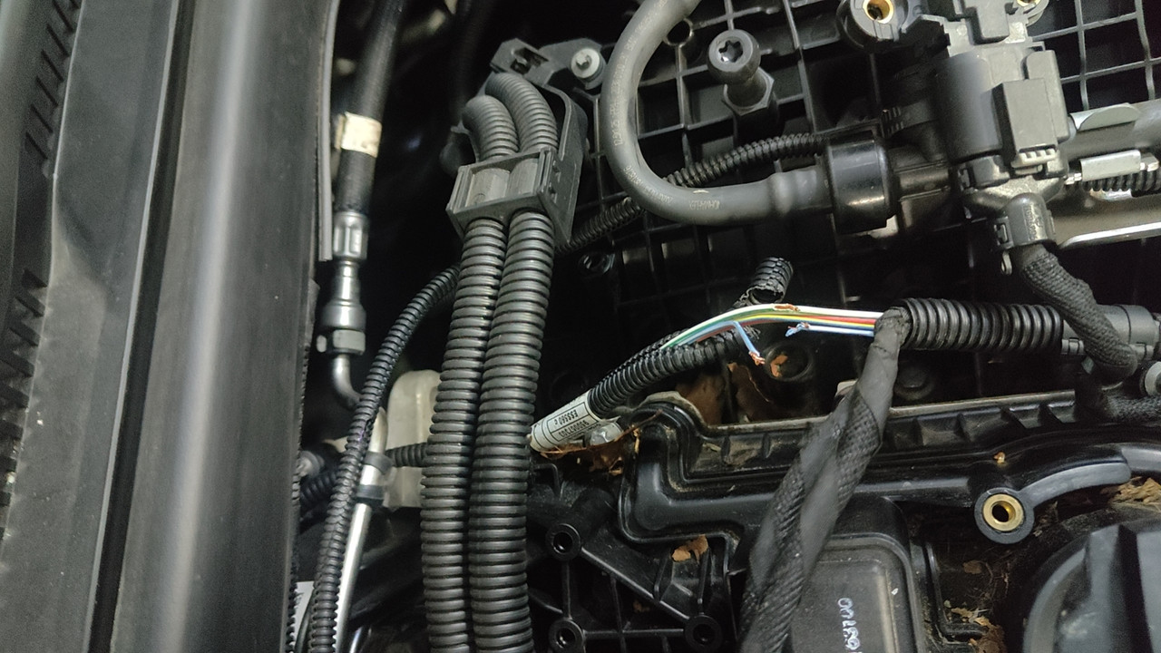

I asked my mechanic to inspect the car and discovered an error code 13070E for the engine module, indicating an engine VANOS solenoid fault and a break circuit.
Guess what? Mice had bitten through my cable while the car was parked! There were also signs of mice activity, like pee and hair, found in my engine bay. I remember that the place where I parked had some mice, but I can't believe this happened.
My mechanic helped reconnect the circuit, and the error is now gone. It seems that the S58 engine enters a limited mode to prevent further issues if a fault is detected by the computer.
Who knew? Mice >>> S58.
