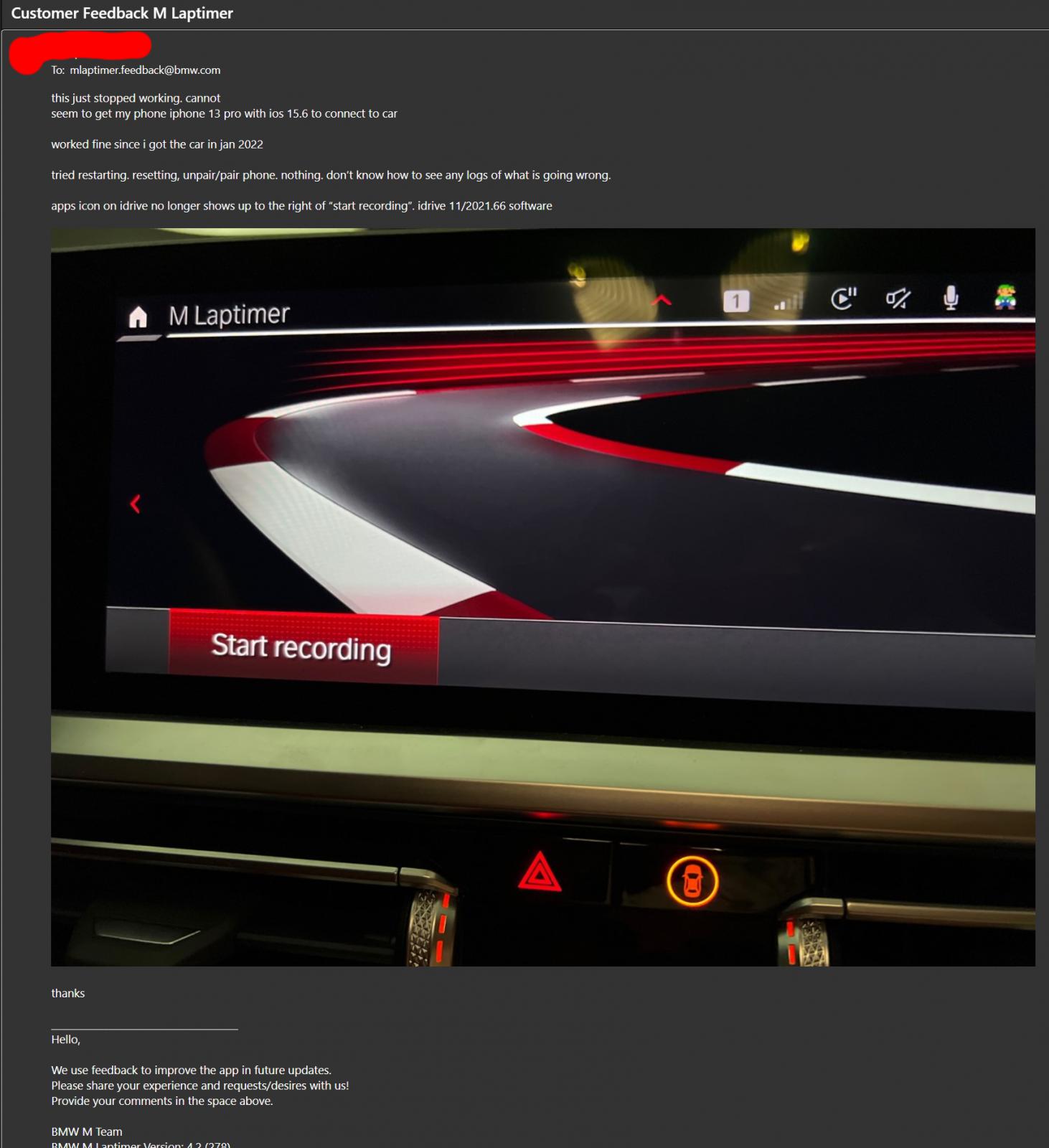

BMW M Laptimer not working (maybe iOS 15.6 related)
i have been using BMW M laptimer recently and quite like the simplicity over Harrys/RaceChrono/TrackAddict

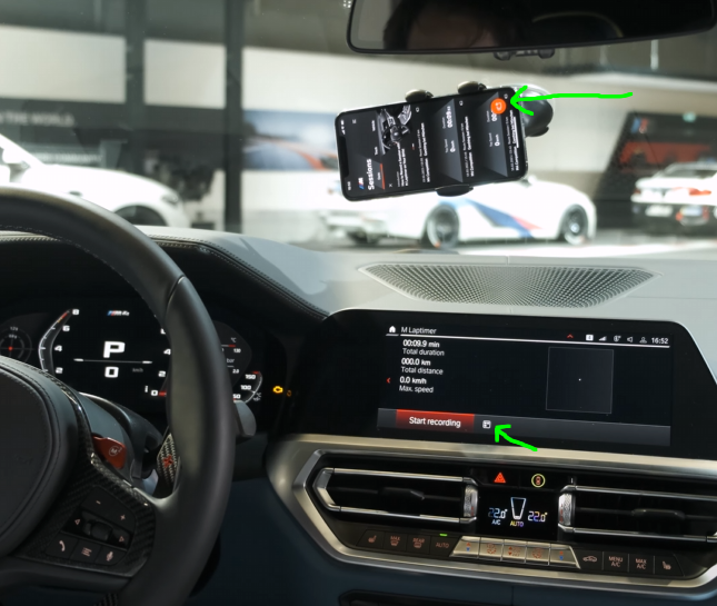

but this weekend i was unable to connect my phone with idrive. normally, i just start up the app on idrive, then startup the app on my phone and hit the red button on the phone when i want to start recording. but now, unsure if its related to iOS 15.6 upgrade, but this weekend was the first time i tried m laptimer since i upgraded..
now when i start the app on idrive:
  • missing that "apps" icon on the idrive screen
  • missing that red start button in the iOS app
i've tried restarting idrive, resetting idrive, unpair/pairing my phone, etc, none of that seems to make any difference.
anybody else using m laptimer seeing similar issues after iOS 15.6

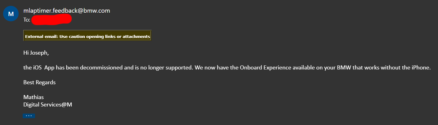

well bmw has stopped supporting BMW M laptimer already.. sad because its telemetry was 10hz and so much better than RaceChronoPro/TrackAddict/Harry's Laptimer with OBD-2 (Kiwi3/OBDLink CX/OBDLink MX+)
i even wrote a program to convert the .mpower format to CSV to import directly into Race Render 3... https://github.com/joeroback/MPower
i asked them if its still possible to get the .mpower data without the iOS app, no response so far, but if that is the case, the M Laptimer iDrive App is basically a big stupid stopwatch on iDrive screen now.. LOL

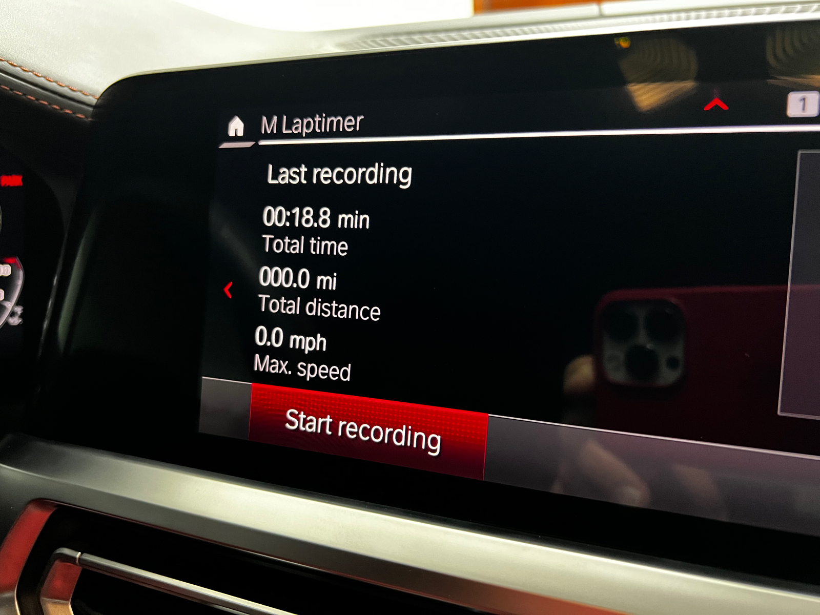

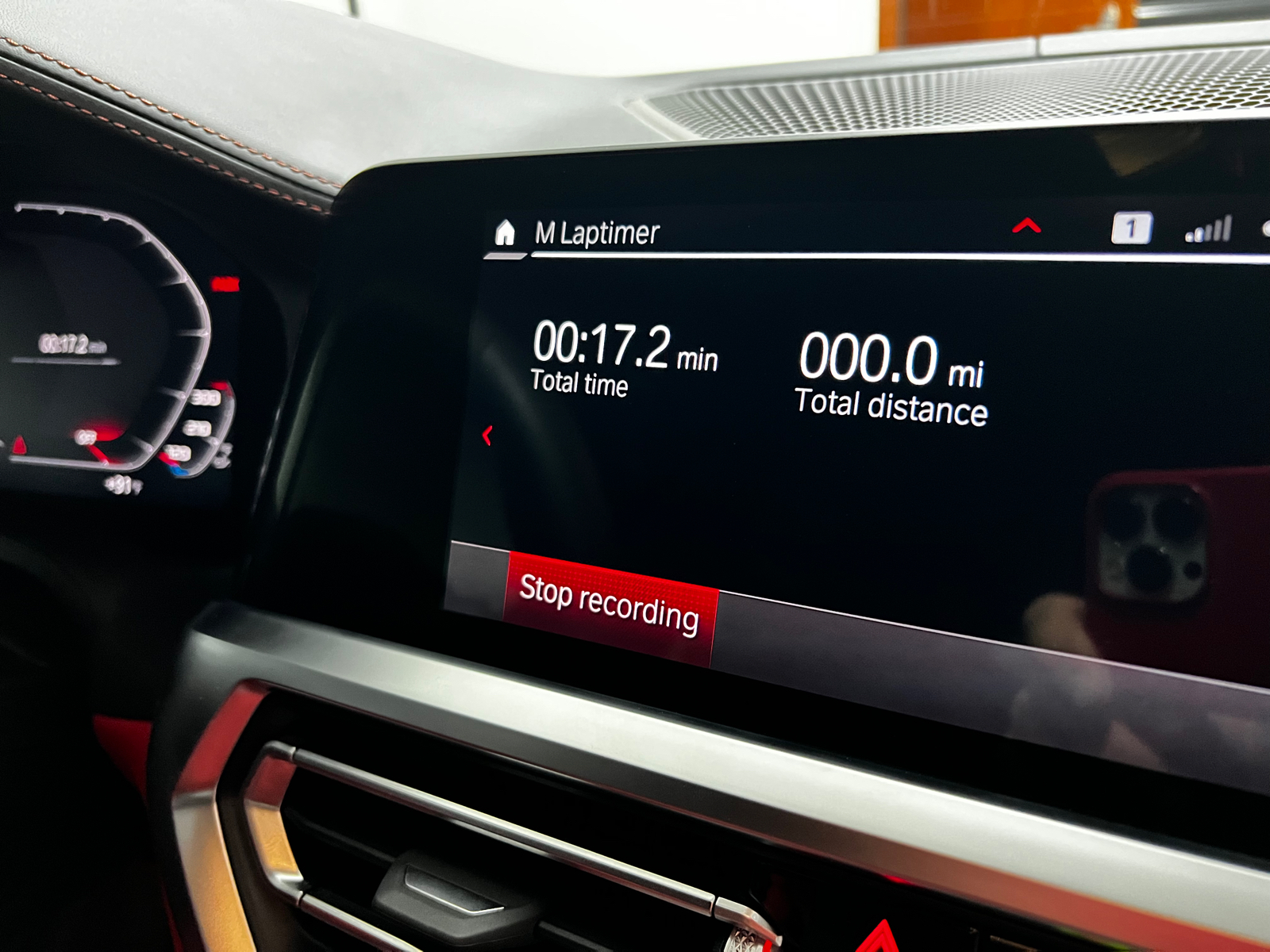

this appears all it does anymore…

I notice this dumb s*** today. Instead of adding to this app they throw it away. Does the onboard even recognize tracks to give you lap times?
no, the onboard is basically a stopwatch now. you can see total time (WOW) and total distance travelled and max speed.. like who the F*CK is going use that for anything??? no more laps. no more lap times in HUD, delta, and best, which was amazing, the delta in red/orange color in HUD
why not just leave it be then??? ok, i can understand no new features, but new features would be awesome... why not just leave it as it is and let us use it?
and why even leave it in the car stripped down like this? to say its still a feature? and not get a class action lawsuit over the $900 USD M Drive Professional, which still says on bmwusa.com configurator that the iOS App and Laptimer are included... LOL

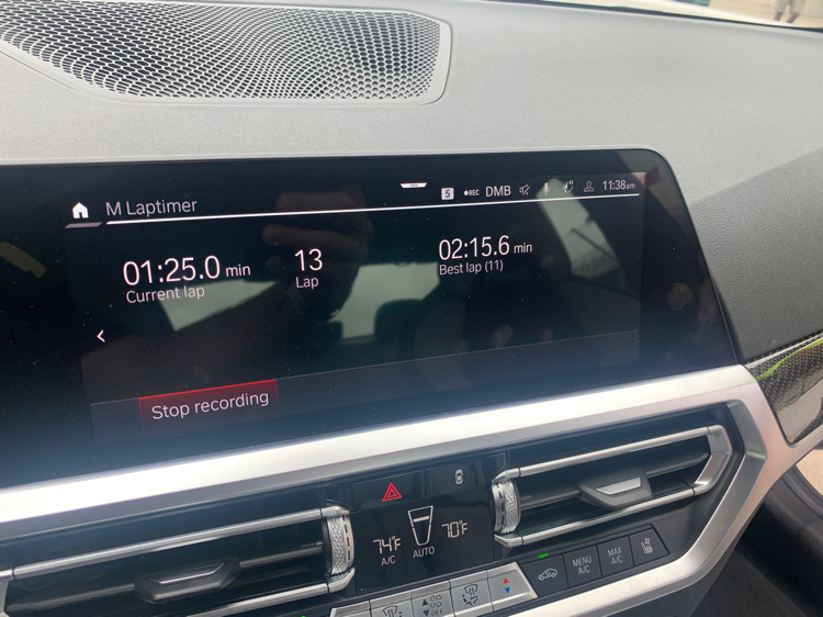

Can confirm, no longer tracking laps..just records the data without individual lap data. Nothing in HUD for lap splits.
