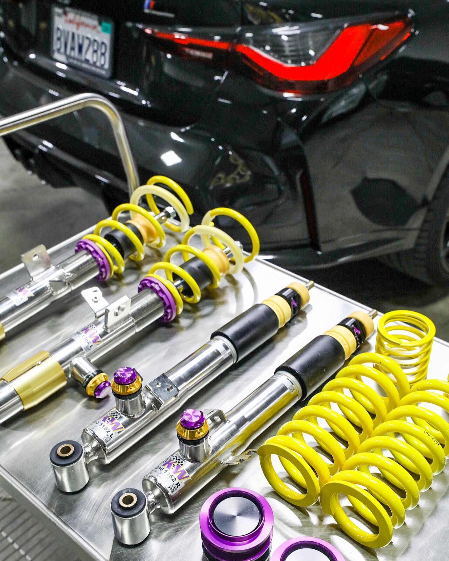

One week before SEMA 2021 we rushed to get our KW V4 Coilovers and RS Future Aero parts installed.
For aerodynamic upgrades, we have a long list of thing we want to test out but started off with a custom front splitter with outwash end plates, rear wing, and fender flares.
The fender flares allowed up to fit wider tires stepping us up from a 285 all around to 305 in the front and 325 in the rear.
The work was finished just in time for SEMA and appeared in our Booth for the show.

SPL was gracious enough to send us every suspension component they offer for the F82 M4. These parts will give us the ability to tune the suspension exactly the way we want it to be.
We spend most of our next track day dialing in the alignment and burning through what was left of our tires. By the we were happy with how the car felt and was behaving.

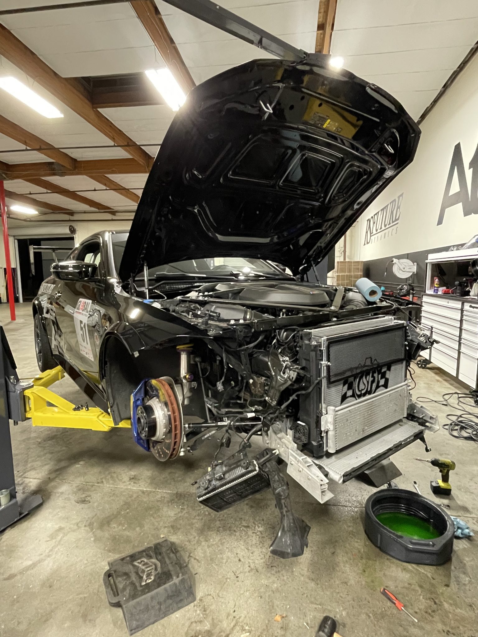

2022 has been a crazy year so far, but we've been hard at work on the M4 and have some exciting updates.
First update for 2022 is from January 25th:
With the suspension dialed in it was finally time to do some work on the engine.

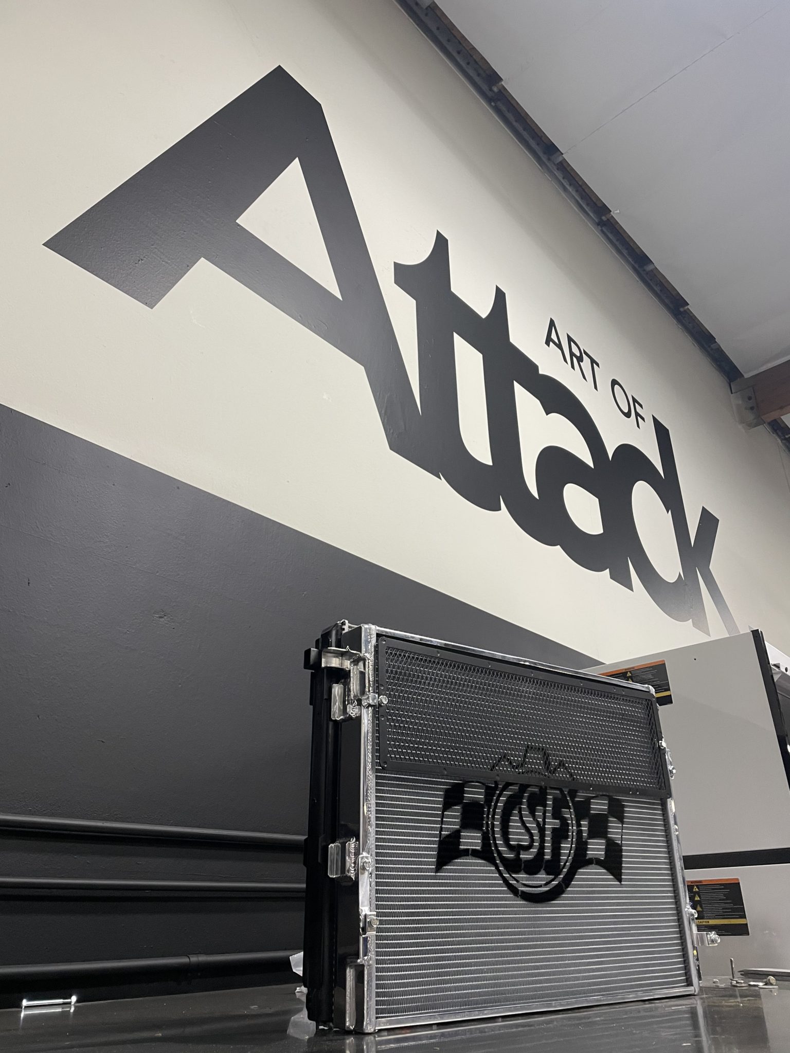

Just like its predecessor the G8X suffers from pretty severe heat soak.
The prototype CSF G8X Heat Exchanger is our solution to combat heat soak and keep our IATs (Intake Air Temperatures) in check as we turned up the boost.
Initial testing showed much more consistent power numbers and lower IATs across the board.

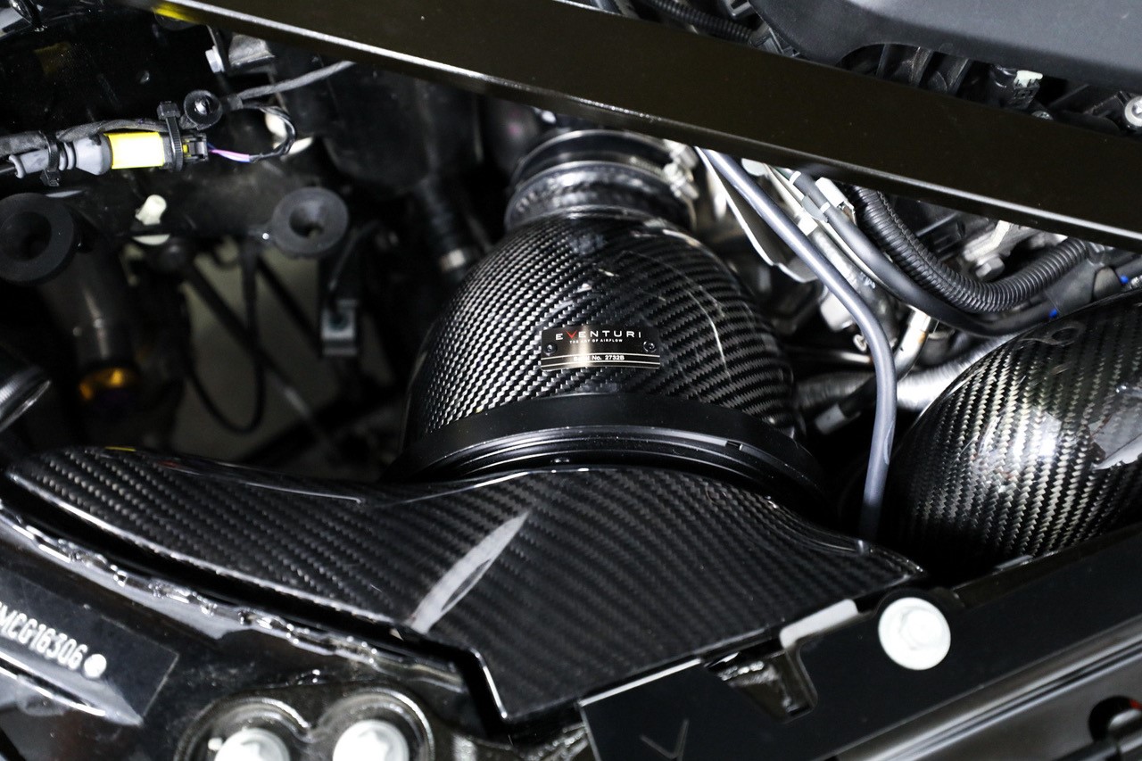

Last week our good friends at Eventuri send us their Carbon Intake system for the G8X and this thing is gorgeous. Eventuri really put in the extra effort in all the little details.
Eventuri said:
We spent a lot of time on the design of this system - in particular the turbo inlets.
I think our inlets and the size of the filters which we have used sets this system apart from the rest. That and of course our Patented Venturi filter housings with how we reverse mount the filters for smoother flow.
We also had recently installed a full Akrapovic Exhaust system paired with a set of Studio RSR Down Pipes.
With the intake and exhaust opened up, it was time to do some tuning. We started off fairly conservatively but still managed to some excellent numbers with E40 Fuel. We recorded a healthy 596 whp and 586 wtq.
