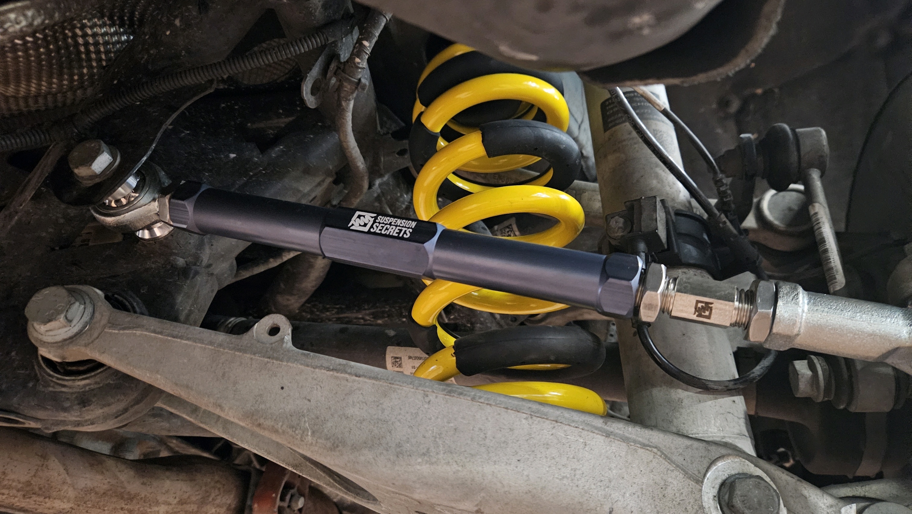

I finally received my Suspension Secrets order, will proceed installing the parts on Monday.
Unfortunately they didn't include any instruction.
1) the camber plates arrived with 8 hex bolts (4 each plate). They are shorter than the OEM bolts. Should I use the ones supplied instead of the OEM bolts? The OEM ones look sturdier.
2) Instead of the non-offset front control arm bushes, they sent me by mistake the offset caster bushes. I am afraid that, together with the SS camber plates, they will give too much caster for a road use. I am thinking to send them back in the exchange of the non offset ones, which are also sealed for better protection of the spherical bearings. What do you think?
3) the rear toe arms don't include a lock-out kit. Should I reuse the eccentric bolts or they must be replaced?
About the torque specs should I use the OEM values?
Thanks

I did the installation today.
I answer my own questions:
1) I used the OEM bolts on the camber plates (new ones). They give me more confidence.
2) I decided not to install the offset bushes and wait to get the non-offset set. Actually I achieved 8.45° of caster with the camber plates only (it was 7.50° oem).
3) installed rear toe arms using eccentric bolts in "zero" position.

Anybody else found the SS toe arms a bit tricky to adjust? Not easy to tight the locking nuts without changing the alignment at all. Also the thread of the adjusting nut is very sensitive to small variations.
Any specific procedure I am missing?
      01-04-2026, 01:02 AM   #110
6795
5,260
Hold the adjuster with one wrench as you do the nuts.
