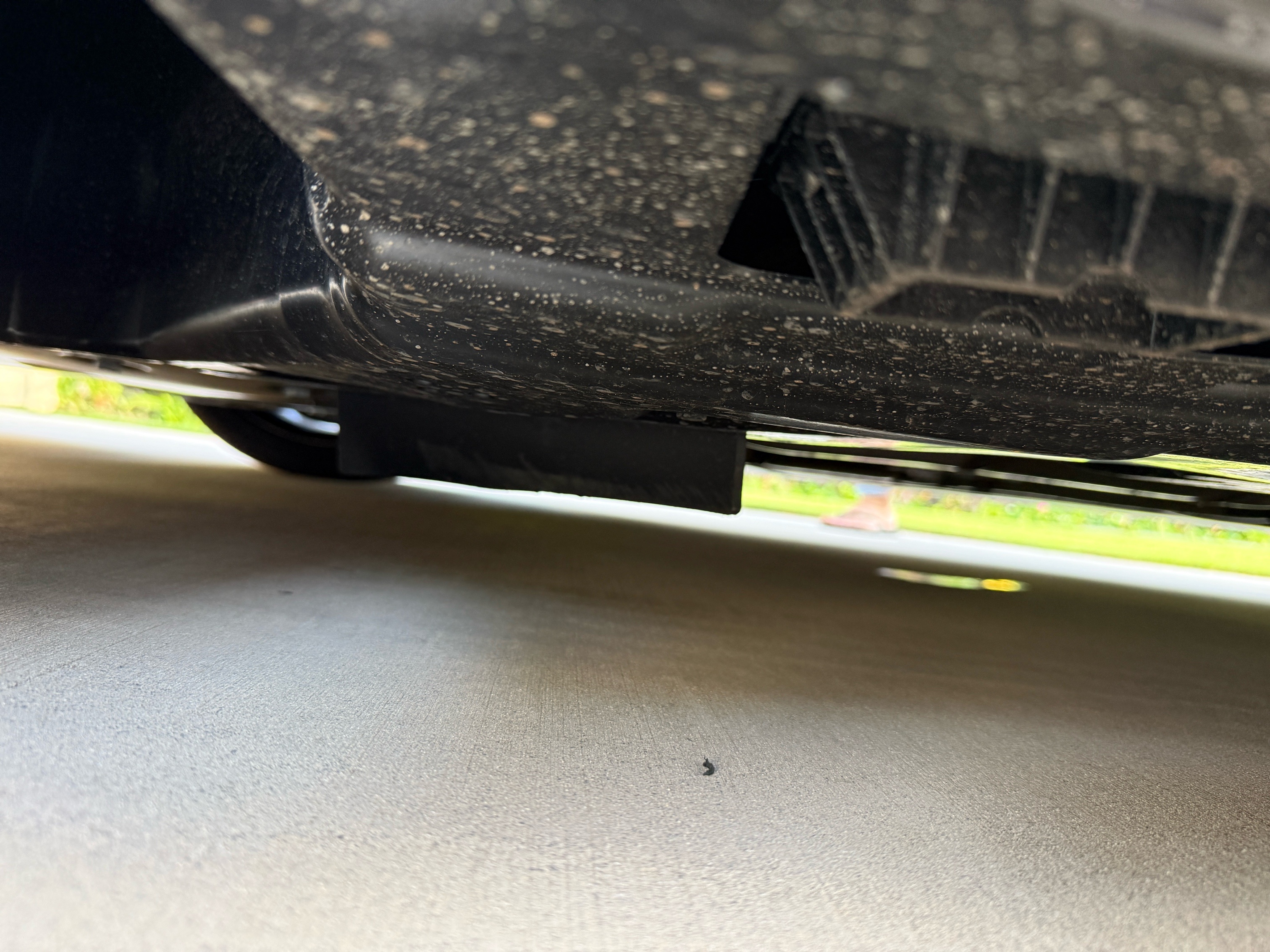

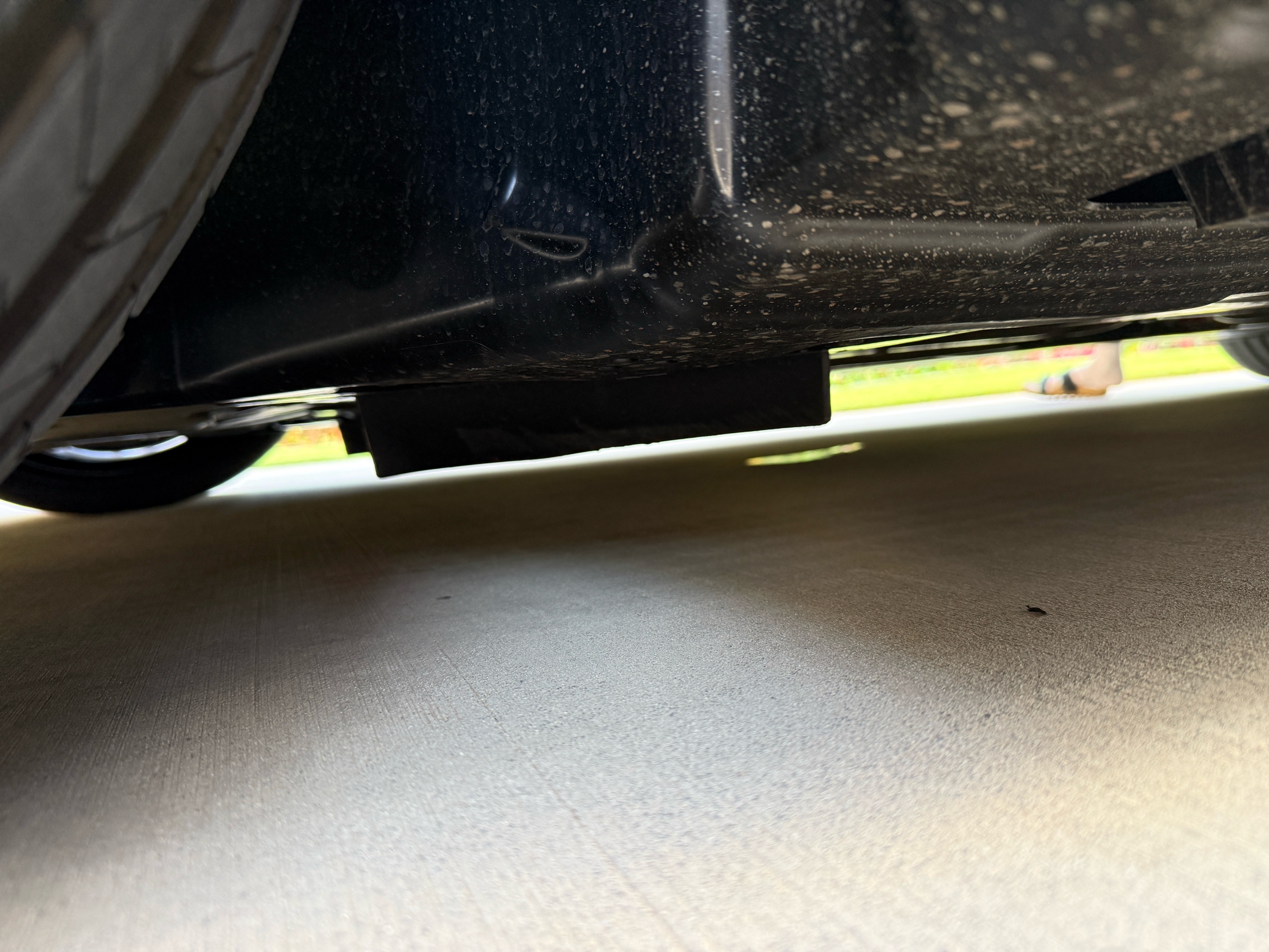

Originally Posted by RonnieDobs View Post
I say go for it. Had mine port installed and it rides/drives so nice.
Are you scrapping the canards under car on speed bumps? Mine seems to always scrape I’m wondering if VPC put mine slammed. If you measure from the ground to the lowest part of fender what’s the inches you have

Originally Posted by twofast2s View Post
Frint and rear max drop. No issues with rubbing with aggressive wheel fitment. Growing to love this setup much more. Feels and looks just right.
No rubbing of those canards under the car over speed bumps? Mine was VPC installed and idk how much but I can hear me scrapping the fins under my car and cringing every time

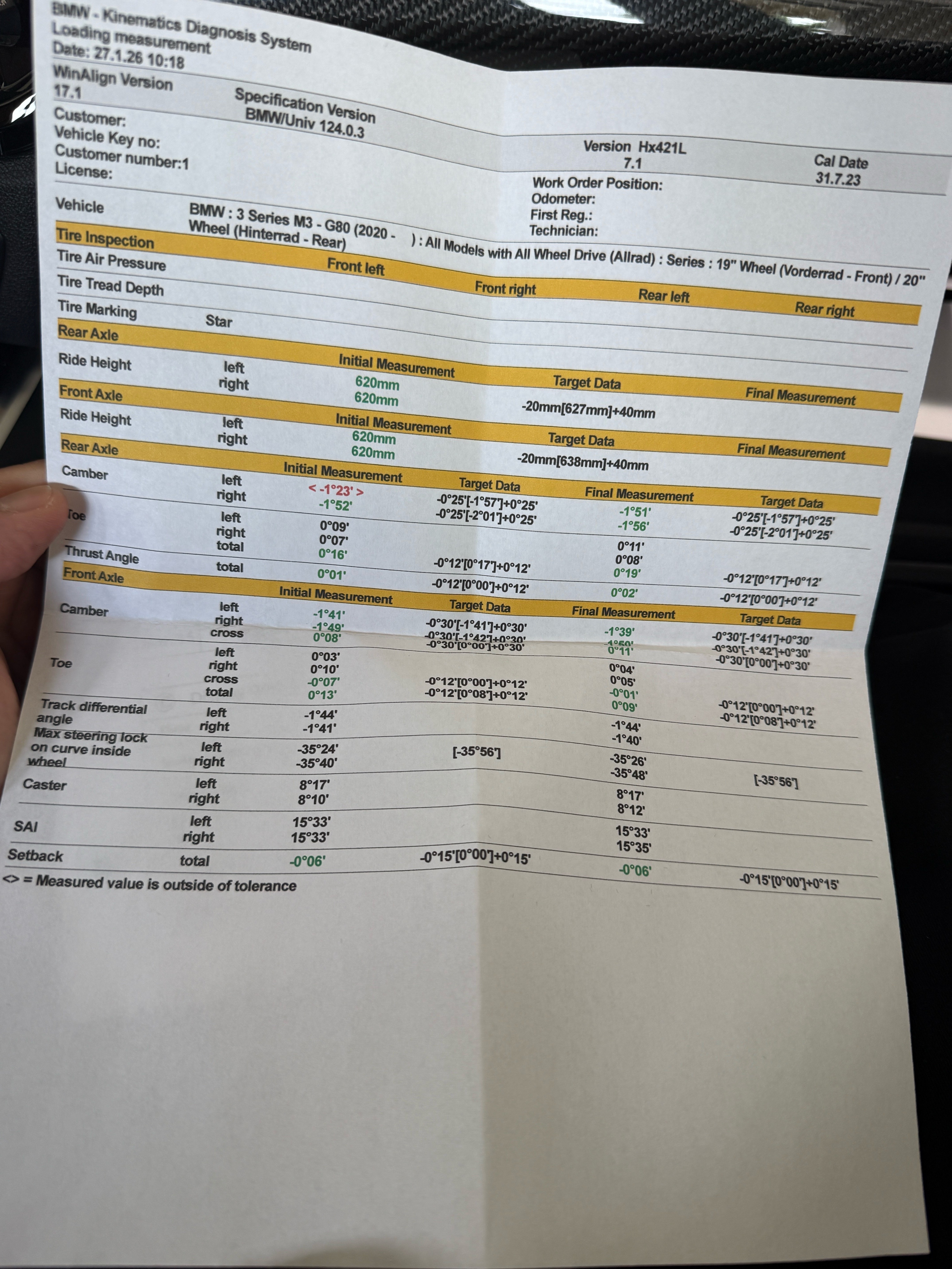

After looking over my sheet that was in glove box does this mean the VPC did max 20mm drop in front and back as noted circled or am I reading this wrong

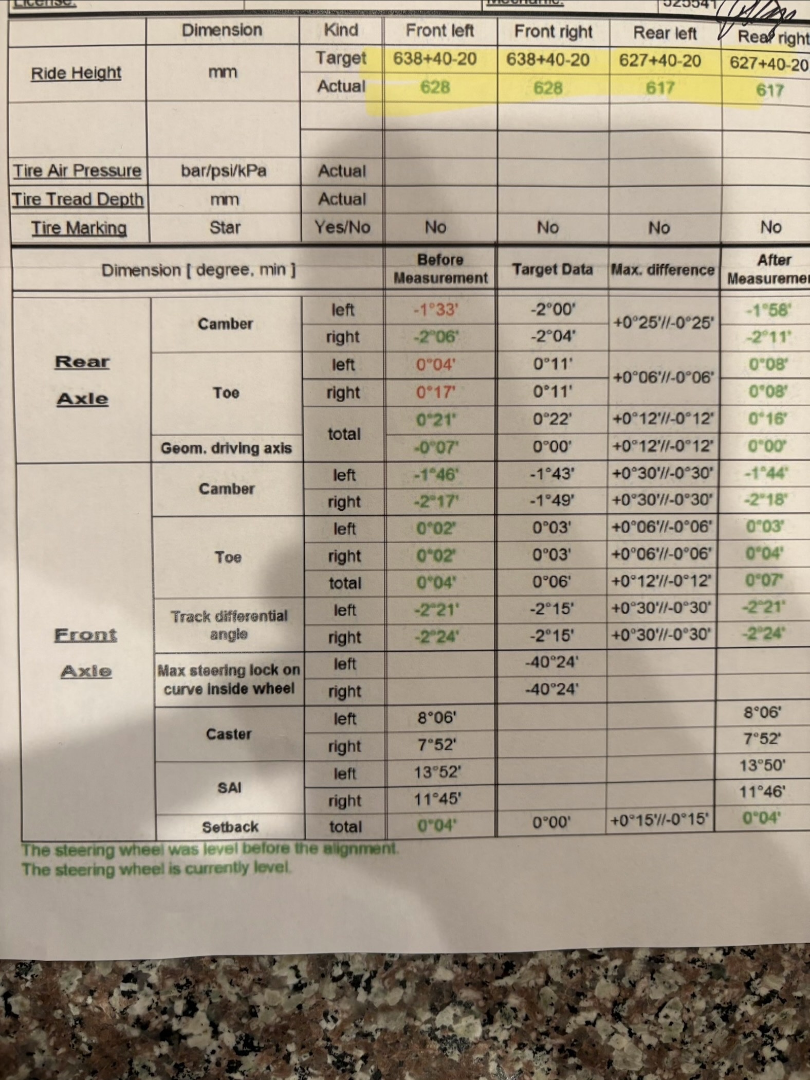

Here?s what mine looks like. If I researched this correctly 638/627 are the stock ride height front/rear. +40/-20 is the adjustability zone. My ?actual? readings show 628 front and 617 rear indicating they only dropped mine 10mm front and rear.
Yours looks different and I?m thinking your ?initial? number reading shows your ride height front and rear. So it looks like they lowered yours 7mm in rear and 18 in front.

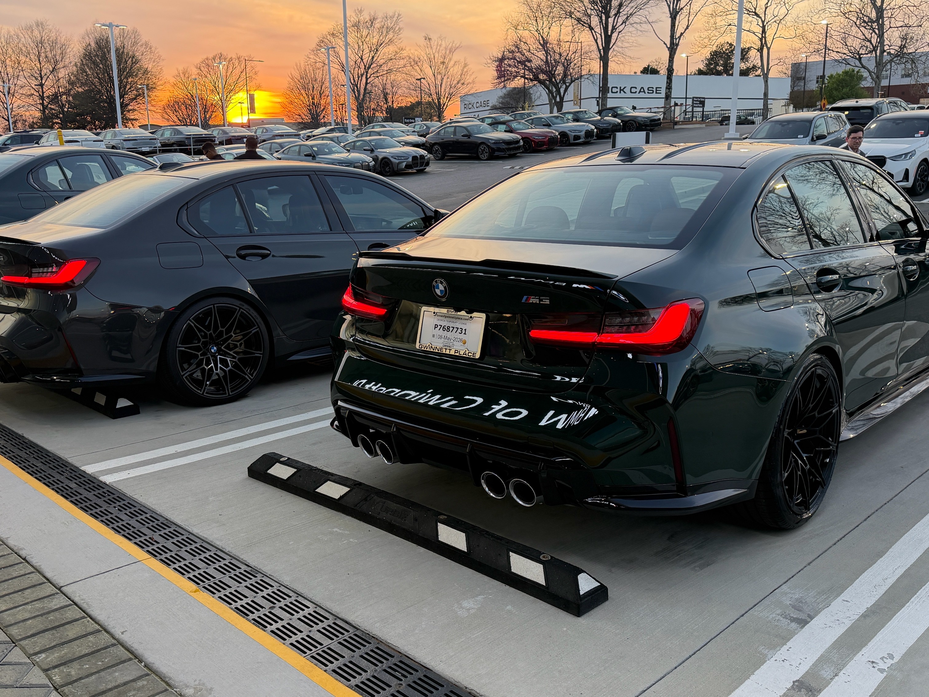

Just for a reference; traded in my 25 G80 base (Dravit Grey/DG) for 26 G80 base (British Racing Geen/BRG).
Took pictures side by side. Both vehicle had port installed MP Has, DG dropped 20mm front 15mm rear, BRG dropped 13mm front and rear. You can definitely see the settling of MP HAS and more than 7mm difference in height.
