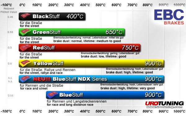

What's the difference between ebc red and yellow?

Reds are probably the best application for most people that don't track their cars. They are fairly low dust no noise (ceramic pads), easy on rotors and they perform closely to the OEM pads and are very cheap to replace. Not a track pad. I run these on another one of my cars are they are superb. Silent, low dust and economical.
The yellows dust a bit more and are apparently for more aggressive street driving but also shouldn't be used at all on track for a car as heavy as the g80. Don't understand what the application for these is as the Blue NDX are better than these and come with the same drawbacks but can be lightly tracked. I ran the Blue NDXs on track all last summer (went through two sets) and was generally happy with them given the price.
EBC has a ton of info on these on their site.
