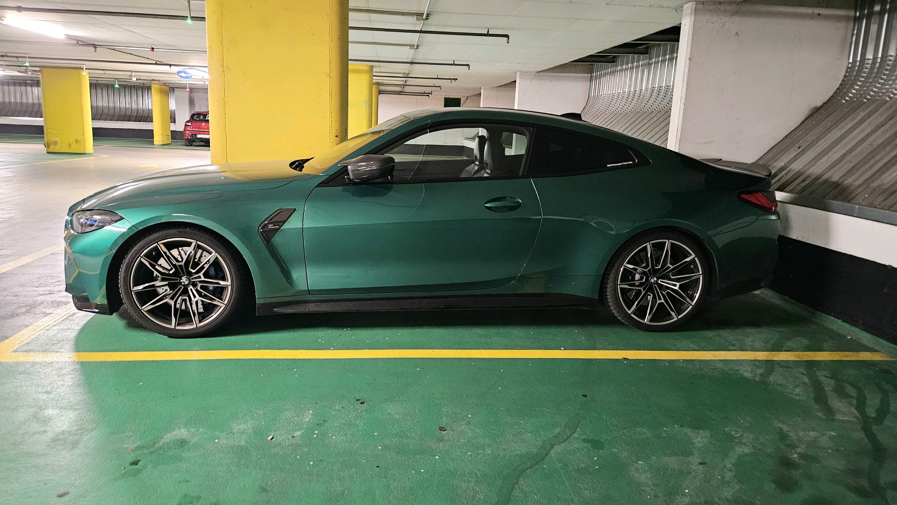

Originally Posted by NiccoSab View Post
I’m installing my KW HAS soon for my G82. Looking for the OEM+ look as well and that’s my planned drop. Can you share some pictures?
This is from last night. Sorry the light isn't the best, I shot it in a parking lot.
I have a little bit more than a one finger gap from tire to fender.
