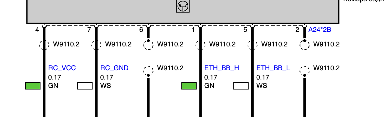

Hi everyone. Do someone knows how can I add surround view option to my vehicle?
Basically I installed all cameras (Front / Back / Both sides in the mirrors )
Everything what I need - create wires for all of those. Looks like nothing hard to me but I'm stuck on wires from Back camera to surround view module.
Can you see this and let me know what does it means: circles and circles with dots ?
Regards,
Sergey

It’s not particularly difficult, but it does require removing several panels and doing quite a bit of wiring. After that, it only needs to be coded to the vehicle. Any necessary diagrams can be found in ISTA.
